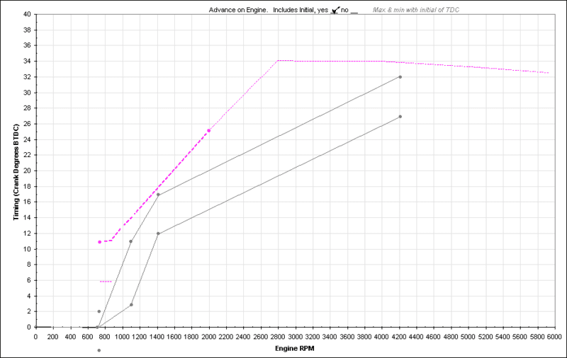

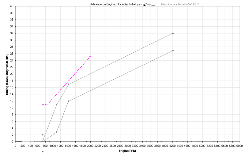

A second primary spring will roughly double the spring force from idle rpm on up. (The factory heavy spring has a long loop. That spring slows the advance only after the weights have moved outward. The one in your distributor did nothing until the advance had increased 12 to 17*)
The curve between your two timing measurements (750 and 2000 rpm) will look roughly like this.
The timing will continue to advance at that rate until the wieghts hit the end of the slots.
So the rest of the timing probably looks something like this. Make sense?
Go ahead and get some real timing measurements between 750 and 2000 rpm.

Initial of 10 to 14* is perfectly reasonable. 26* a 2000 rpm may be too much, and 32 at 2600 rpm is certainly way too much with vacuum advance. it may be OK without vac advance but with the really load and low octane fuel, I dont know.

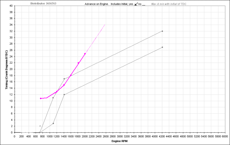

The timing numbers I already have up to 2000 rpm are as follows - 13* at 1200, 15* at 1400, 18* at 1600, 22* at 1800, and again 25* at 2000 with the initial set at 11* at 750 rpm. I also recorded 48* at 2000 with the vacuum advance connected. Granted, that is no load revving up in the driveway so it could be pulling in slightly less advance on the road. My math on cruise rpm at 55 comes out to 1932 rpm with my 2.76 gears and 26.4" tall rear tires. I could be reading the tach slightly off while driving as I didn't think that 68 rpm of slip sounded like very much. So if I'm reading the charts you provided correctly, I actually slowed down the lower end of the curve with my advance spring magic and really should re-install the long loop spring before going any farther. Thanks again for all of the info and help. It may be several days before I get a chance to plot the rest of the curve I have now and I'll re-verify the lower end as well. I'll also verify the reading of the in-car tach at several points.
Here's the timing you measured overlayed onto the factory and it shows the advance from 750 to 1400 rpm was slower.

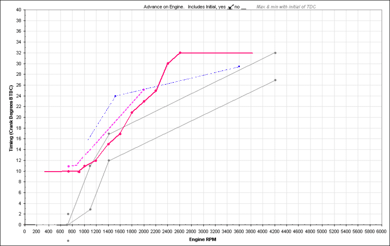

Very quick update as I don't want you guys to think your efforts to help are wasted. I did get to drive the car on a hot day early in the week with vacuum advance unhooked and experienced no pinging at any time. Part-throttle acceleration definitely was not as crisp without the advance added by the vacuum can. I haven't got a chance to touch the car since.
Ok, I have more info. I went ahead and re-checked the entire mechanical advance curve as follows. Initial 10* at 700 with 19" vacuum in park. Drops to 600 in gear at 15.5". 10* at 900, 11* at 1000, 12* at 1200, 15* at 1400, 17* at 1600, 21* at 1800, 23* at 2000, 25* at 2200, 30* at 2400, 32* at 2600 which is full mechanical advance. The vacuum can I am using adds 2* at 7", 8* at 10", 16* at 12", and 20* at anything over 14" and it is hooked to ported vacuum. At 55 mph 2100 rpm I am pulling 16-17" vacuum going up the hill in question and it will start rattling if you don't start letting off the throttle until you crest the hill. Obviously, I am pulling the full 20* of vacuum advance under those conditions so it makes sense that unhooking it got rid of the ping. At 40-50 mph on level road it is pulling 20" and 55-60 on level road it is pulling 17.5". Under what I consider normal acceleration thru the gears, it is pulling 12 - 14" of vacuum which is adding 16 to 20* of timing to the mechanical. I see several options if I am understanding things better now as I think I am, in no particular order.

Nice job. I agree with your conclusions
If you can put the long loop spring back in, that will probably get it done.
When the distributor is open, move the weights and see roughly how far into the advance before it contacts.
For example you measured 22* advance on the engine. If the weights moves about half way up the slot with the long loop spring, then it will add its spring force approximately 10* into the advance.
You can turn the spring perch to adjust that a few degrees.
With only one primary spring, the advance will begin at a lower rpm. Turn the perch to add more initial tension if possible.
You could also try delaying the vacuum advance, or doing so in combination with using the longer looped secondary spring.

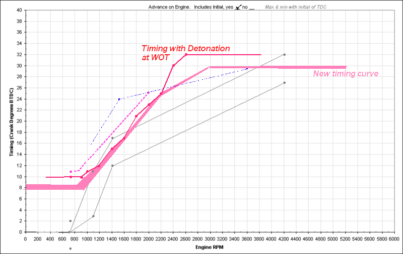

Ping update. I tore into the distributor and put the factory long spring back in place and also added a little tension with the perch. Once I got in there, I discovered that I had actually replaced the long loop spring with one of unknown origin that was lighter tension than the factory primary spring. Therefore, the curve from idle up to 2200 rpm ended up basically the same. I think I see now why it's recommended to weld the inside of the slots rather than the outside so the springs start out with a little more tension. The curve now has a linear increase from 25* at 2200 rpm up to max advance of 30* at 3000 rpm. Max advance was occurring at 2600 rpm before. I ended up having to live with 8 initial timing for now as I still was having some slight pinging at wot. I've made several wot runs from about 25mph up to 65mph in 2nd gear with no audible ping. I also adjusted the vacuum advance to pull in 2 degrees less timing at 16" vacuum which ended up being 1 1/4 turn ccw. I figure I could probably bump the initial timing at least a couple degrees if I ever get a 3.23 rear. Hopefully, this saga will help someone else in the future. Thanks again for all of the suggestions and help.
:thumbsup:
I wasn't sure how many strokes to max is normal.
Pick a number between 3 and 5, or as you observed if the cranbking rpm is dropping, then it may take another compression stroke or two to get max out. As long as you have notes and its repeatable test method, that's fine.
If that engine likes a little more initial then this
would be the way to accomplish that using the same springs.
Roughly sketching out the new timing set at 8* initial, its not too surprising it was pinging a little with more initial.
If you're satisfied where its at now, great.
If at some point you want to or find you have to get back in the distributor, welding up the inside is one adjustment, and engaging the long loop spring earlier is another. (Or try to find a slightly shorter, heavier long loop spring). I think you see that they do different things.
