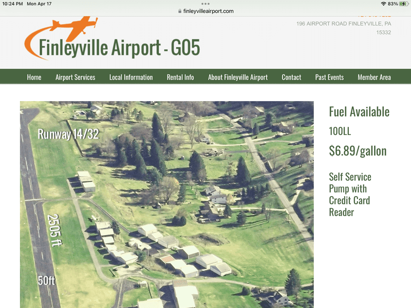

Aviation 100 Octane Low Lead at your local airport
