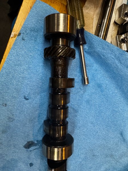

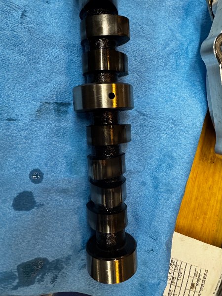

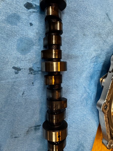

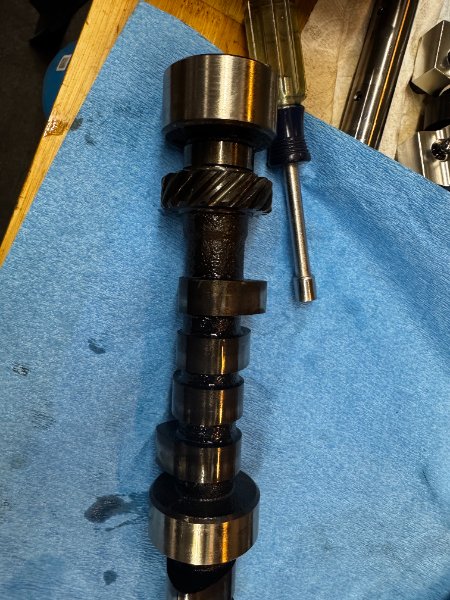

I finidhed the disassembly, no smoking guns. Double checked the degreeing of the cam and checked the duration of intake lobe as well as all 16 lobes for lift while still in the motor, They were almost all within .005 in. from spec. Could have been even closer but I was just checking that none were really off. I did not check for timing of each lobe. I don't even know how I would attempt that. Nor did I check duration for the exhaust. Tells me that nothing was defective with the cam, the timing or the valvetrain. As I have said previously, the car ran well, I just think it has more to show. I am trying to do this methodically. I have extensively refined the EFI tuning, checked fuel delivery, adjusted various timing events. The last 2-3 items are, Get a new cam (on the way), New converter, ??.
