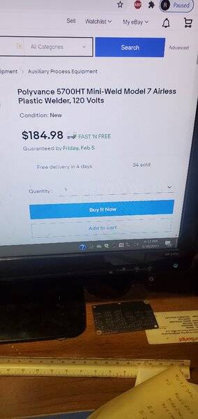

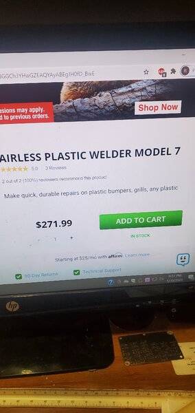

here are 2 i found but looking for advice/real world experience.

My brother borrowed a plastic welder and I used it a bunch. It was a 1200 dollar machine, but it worked. I welded up several plastic tanks and other stuff.
IDK how those cheap ones work.
