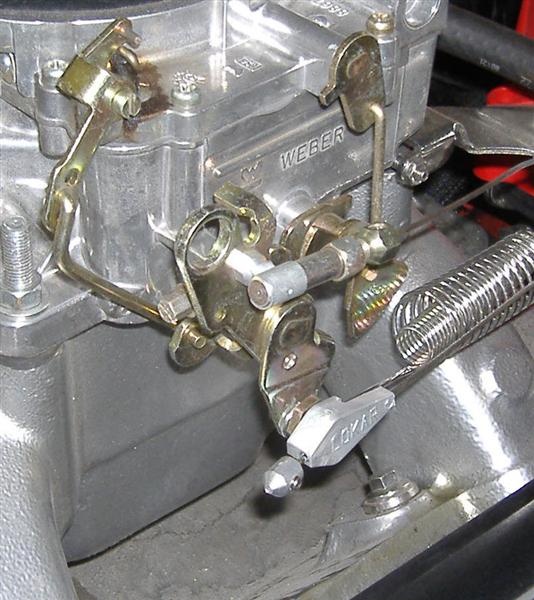

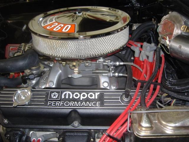

Cool very nice setup. Anyone have an edelbrock carburetor setup with cable driven lockdown linkage pics??? Thanks!
no pics and its rainging go the easy route Lokar. u buy the kickdown cable and throttle cable with the bracket very nice and clean setup I went with steel braided cus I thought it was better looking then the blk.
I have a lokar style kick down linkage and bracket but I was really wondering if I could run that cable driven kick down with a stock throttle cable? I guess I can always go buy a lokar throttle cable also but was wondering if the two can be mixed and matched?
Nice setups guys! I see that most of you are not mixing and matching cable and stock linkages.....? Hmmmm. I guess ill either have to buy a lobar throttle linkage setup, or put back my old kick down linkage..... What do you guys think?
Get the lokar and never look back. Jphnny dart that sure is clean, makes me sick. I thought mine was nice but it dont make a pimple on your ***.
