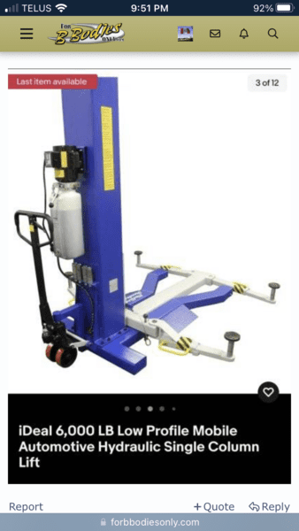

I have done a bit of snooping around the net , would you feel comfortable with car on this ?
iDeal Mobile Low Profile Single Column 6,000lb Lift | Pallet Jack Car Lift Style Redline Stands
If you were ever in a shop when a car fell off a lift you would not even consider this. What is your life worth ? Your buddy ? kids ? wife/Girlfriend. You get someone killed you gotta live with that. Not trying to be mean but save some more $$$ and buy a drive on 4 post lift
For about that money you can get a 4-post lift that would be much, much safer.
I too want to have a lift. This looks a bit scary to me. I see the cars sitting up there, but still doesn’t look as safe as a four post lift. Not cheap either
