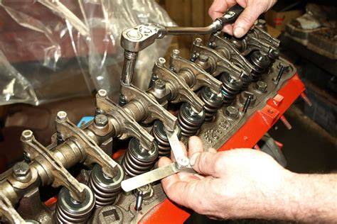

Readjust your mechanical valves, that will be a big performance boost in itself.
