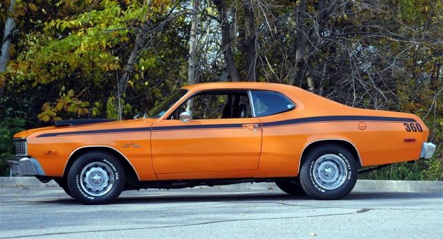

Front
BF Goodrich T/As 205 60 15
classic industries steel 15x7 wheels
4" back space
stock suspension
back
BF Goodrich T/As 245 60 15
classic industries steel 15x8 wheels
4" back space
stock suspension - rolled quarter lips
