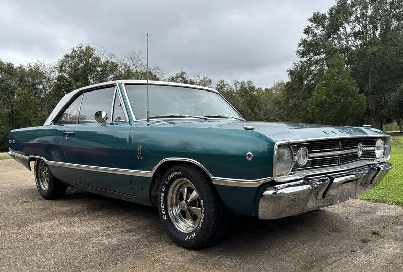

I know this is from an old post but what does "Low Pad" mean here?
Fronts are 17x8 5.5BS low pad with 245/45/17
Rears are 17x9 5.5BS low pad with 255/45/17
Thanks.
Your car looks great!
It reffers to the shape of the portion of the wheel that connects the hub to the outer wheel. It's shape allows for different size calipers. A low pad design wood be for your stock or smaller brake setups. Weld does a nice job illustrating this on their website
