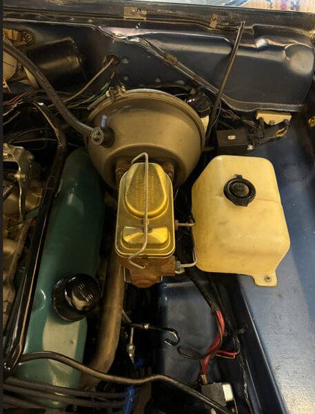

Hello, I wanted to see if you guys had any insight into my power disc brake operation. I've got a 67 Dart GT 440, 4spd with power disc front brakes and rear drums - stock components. I have a manual proportioning valve to limit the rear brakes. This setup is 10 + years old and under normal driving conditions works fine. However, when applying brakes in a hard stop it feels like the pedal hits a hard stop but the brakes don't feel fully engaged. No matter how hard I press I don't get anymore braking power. I'm wondering if this is a limit of the early stock disc brakes or if I have something else going on? It's been like this since I put the car together and I'm finally going through the car and tweaking the stuff I'd like to work better. The question is this normal and if not what can I try to correct?

Pedal is rock hard, travel is "normal" 1 inch or so. I believe the MC is 1 inch bore. It's stock MOPAR stuff. I'll take a pic of MC and Booster

OK a bit more about the system - picture attached. The calipers are 4 piston and along with rotors are a stock setup correct for a 1967 A body. The MC and booster I believe are also a stock setup, 1967 was first year for dual lines on MC for front/back. There is no air in system as I use a motive auto bleeder kit from Summit ( well worth the $60 - I highly recommend - Motive Products 0100 Motive Products Power Bleeder Kits | Summit Racing). I recall something about the rod adjustment that Dana 67 Dart mentions and can revisit that. Does anyone have good instructions for doing the adjustment? I will Google but that normally lead me back to this site :) Thanks for the good feedback.

This sounds like a booster problem. The booster has internal valving to modulate the line/output pressure, which I suspect is faulty. Low pressure on pedal=low output pressure; higher pedal pressure= higher pressure.
a regular oil hose to the vacuum canister can collapse, so there is no vacuum at the booster! they are build for presure not vacum
I don't think its a vacuum or canister issue. The pedal operates freely and power assist feels right. It's just on a hard stop I seem to run out of pedal which limits the pressure to the brake. I'm hopeful adjusting push rod will help. Will advise when I've been able to adjust and test.
