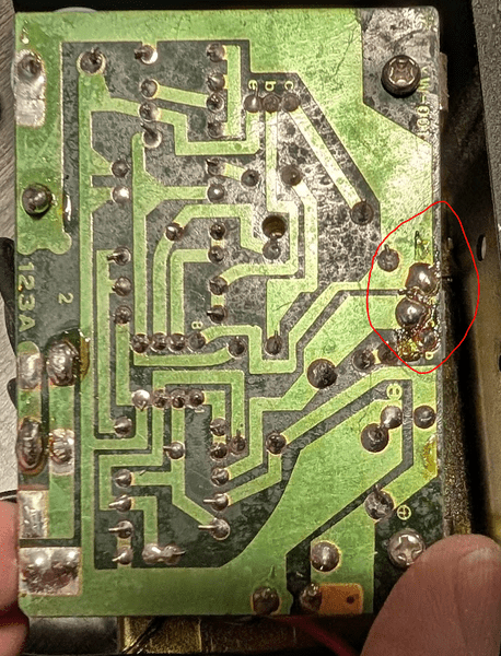

pin side of transistor circled in red. only thing that looks iffy at all

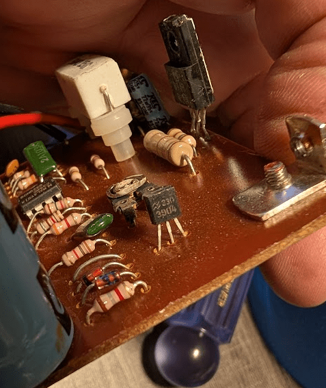

My guess is this pot (only one on the board) can adjust the output voltage
B948 -> Silicon PNP Power Transistor 2SB948 datasheet(1/5 Pages) SAVANTIC
Found the positive output lead was loose
3904 -> a common NPN bipolar junction transistor used for general-purpose low-power amplifying or switching applications
only IC on the board
C358C -> LOW Power DUAL Operational Amplifiers
even the CAP looks good, no bulging etc
