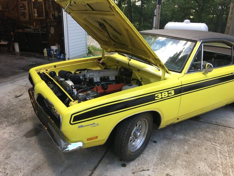

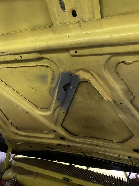

I have Proflo on my 69. It is on a 440 and I did have to notch a 2” area of my hood support. I’ll see if I can find a pic, if not I will try to get one taken tonight. In the attach pic the support that goes right to left has a small cut out on the rear side of it. I’m not sure what motor or Mounts you have it all may make a difference.

Isharj here is a pic of the cut out I had to put in one of the supports under on the underside of the hood.
