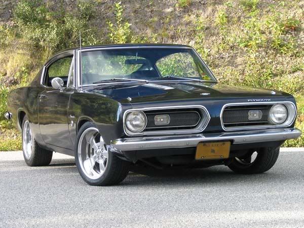

Something like this maybe?
I never posted a project log, but that was taken before I even re-did everything.
I have a nice long list of mods done, and waiting to be done still, but all on a budget.
