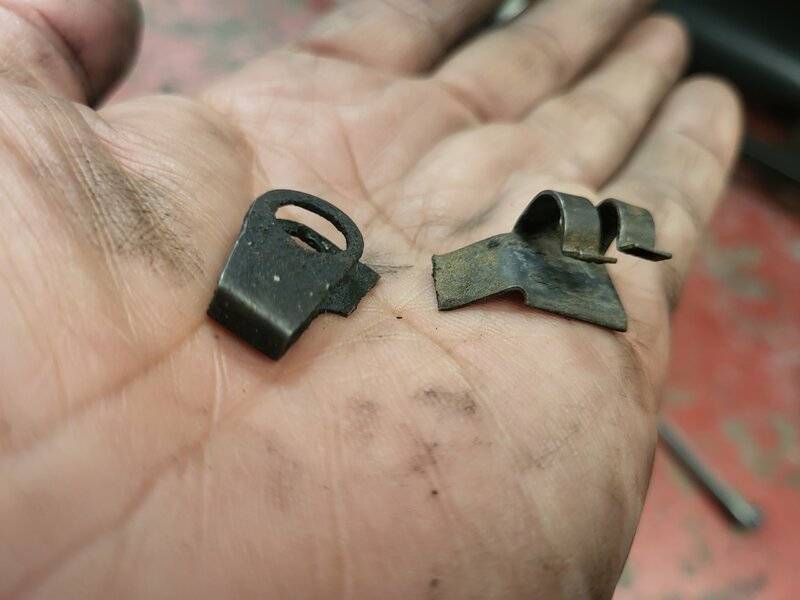

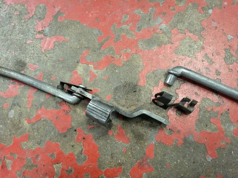

I have a 1966 Barracuda 273 2bbl, and the linkage rod for the auto choke is not the correct length,...so the choke doesn't open all the way once the engine is warmed up. I don't know if this is the original carb, but I don't think so. I discovered this problem during a full engine rebuild. I also need the clips for the kick down linkage rods. Photos attached. Thanks
In the first pic, I don't see a problem with the link-rod.
I only see that the choke is partially closed because the bi-metal coil is cold or adjusted wrong.

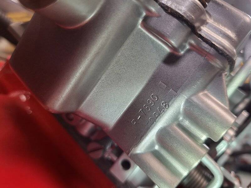

Hi folks. I found a set of numbers on the body of the carb. Does the "R" stand for Rochester? Does anyone recognize this? Thanks.

The car has a number on the side (see photo) "R-7890". Is that a Rochester? Do you know the PN for the correct Carter 2bbl carb? Thanks!
First, not sure what carb that is. Definitely not OEM 66 Carter BBD. You can bend the rod till the choke opens all the way at operating temperature. Second, the choke should be fully closed when cold. Next, the pull off should "break" the choke open when it starts to a specified gap. Only when these conditions are satisfied, should you adjust the bimetal spring by removing the choke, loosening the adjustment screw and turning the assembly one or two lines, and tightening the adjustment screw. You would much better off finding an original Carter BBD carb, 1966-197
I'm not sure where the numbers are on a BBD Carter. Any Carter BBD for a 273 or 318 will work well from 1964-1975 ish. You might want to post a "wanted" thread for a 65-75 Carter BBD 273 or 318. I have never seen that carb on a Mopar, but I lost interest in "newer" stuff about 1975. Sounds funny today.
