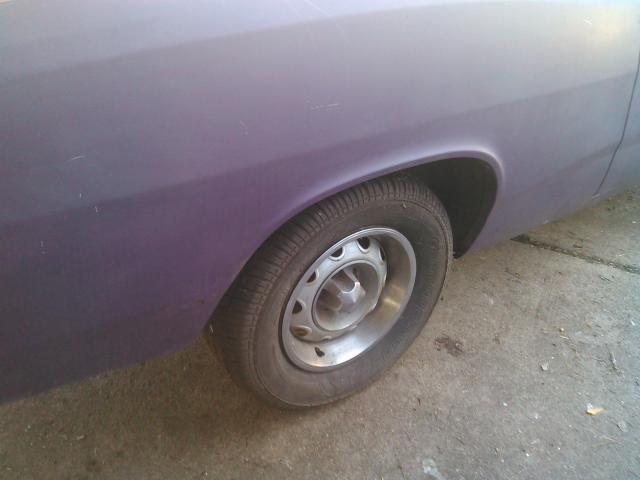

Actually, it's a cool car because it was so plainly optioned, i bet the rallye wheels were added. All rallye wheel cars in '73 were big bolt pattern, and your car would have had the small bolt pattern seeing that it had manual brakes. If it had power brakes, you got the bbp front disc brakes automatically and a bbp rear end. They did not install sbp rallye wheels on cars after the '72 model year from the factory.
