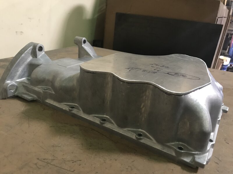

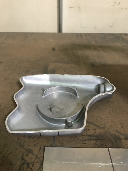

Here is what Boosted Motorsports did to gain ground clearance for his Viper install.
The oil pump hangs pretty low, so can't really go any further without some kind of a custom oil pump setup.
Nice thing is, it's a rear sump pan so there is some possibility of clearing a k-frame.
I say a death wheel has some real potential.
Almost exactly what I had to do to my J35 for pan clearance.
