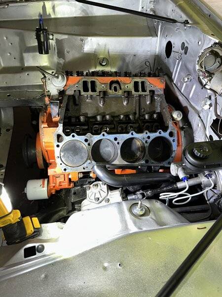

Late night madness, I need an engine hoist so I can get the b body headers out and reach the last 4 head bolts.

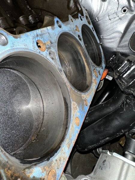

.030 flat tops over and cross hatch looks good with no cylinder ridge.

Your going to be busy this summer. I'm just glad I'm out of garage Oklahoma garage is a sauna...lol! No big upgrades till it cools off and it saves me money. Excited to see that running love the big block!

I’m trying! Working in the heat is killing my motivation, but I’m getting there. Your build thread is great motivation for me, your car is awesome.

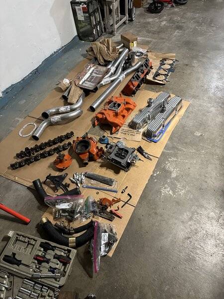

Motor is on the stand and oil is drained. Will report back tonight with more. You can see how close that 402 pan sits to the K frame, orange paint from it rubbing during removal. My final thoughts on the B Body Hedmans in the last picture.
#6 needs an access hole, it can be done without it but you have to crawl under the car and not much room. Other than that plug access is great and no tubes get in the way.
All in all the Hedman 78030 fits the low deck very well, I've installed over a half dozen sets in Darts, Cuda's and Duster's.

I don’t disagree on the final fit at all. But removing them and reinstalling them is nightmarish IMO. If I was racing on a budget, or just wished for max HP per dollar I don’t think you have another choice. If you like to tinker and change stuff as much as I do, I’d go for something with easier install.
