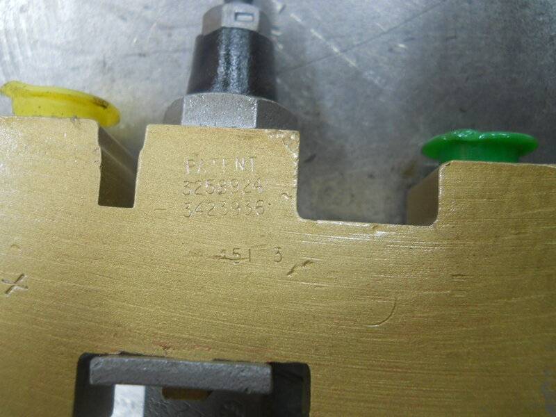

There are two different style which are interchangable. Weatherhead and Kelsey hayes. You can see the physical difference in the pics I posted if your eyes are old like mine and cannot see the small logos.

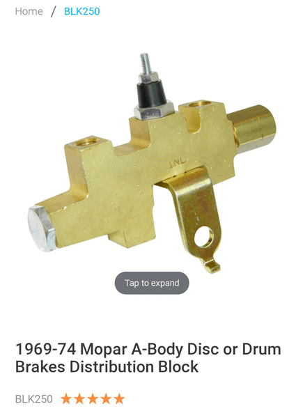

Hey Old Man.. I was just thinking about you and wondering if you had an original you'd sell??. I have a factory pre January 1970 I can trade with but mine takes the one with the octagon shaped adapter.. I don't know what happened to the original that came on my Demon.
I had the same exact issue. Annealing the washer did not work for me.
Wound up buying a rebuild kit and an original from a poster here and it hasn't leaked at all.
What do you mean by the octagon shaped adapter? That would be some sort of 8 sided piece. The parts I have pictured are off of 70-71 a-bodies with disc brakes . Inline tube shows pics and PN#'s find yours and post the number you need. I just bought one for a 70 challenger Same as A-body but has a mounting stud vs. hole
It needs to have this fitting. I don't have the one that came on my car.. I purchased 2 re-pops and they both leak.. I'm looking to buy an original.
