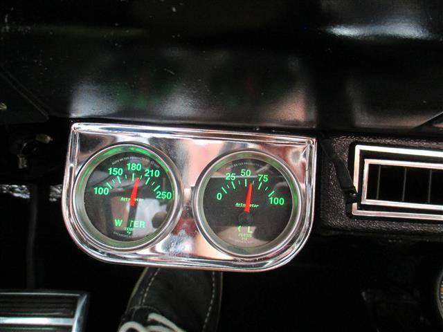

        Put almost 75 miles on the car this morning. A mix of mostly freeway & some surface street driving over a period of 2 1/2 hours. Temps never got above 205* & predominantly stayed between 195-200* :)
        AC was on the entire drive & plenty cold!!
