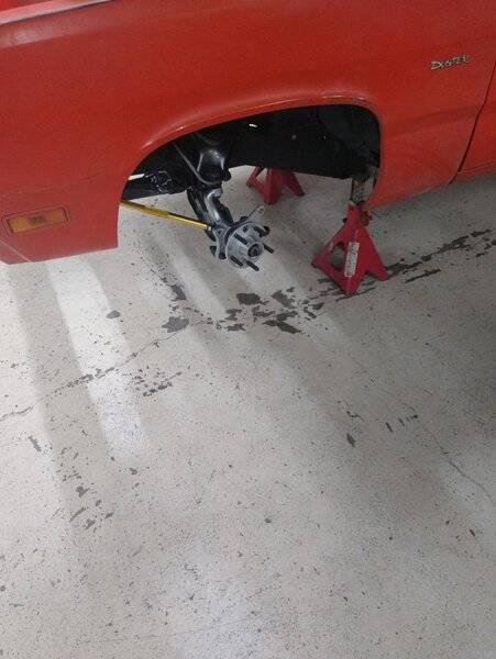

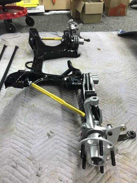

I've used 3 sets. All are an improvement over stock. These are in Krusty.....
