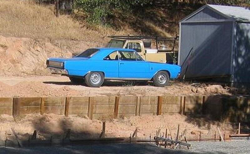

This is a 67 Dart with a 66 B body 8 3/4" axle....Wheel Vintiques 15 x 8 Rallyes, 6" back spacing.
This was 15 years ago but the tires were a 255-60-15.
