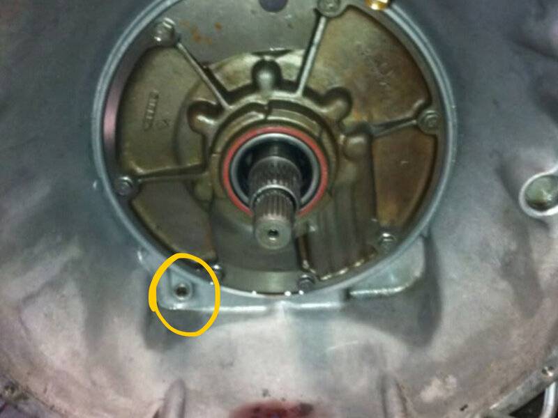

Pic #2 The bore for the pivot shaft is behind this circled plug. The shaft will come out the front. They had this problem before, see the strut with a welded brace on it.

A couple 1/4" wobbly extensions can usually get the plug out without pulling the converter. Once the plug is pulled, you can slide out the shaft enough from the bottom to pull and reinstall the band lever.
