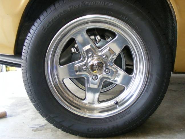

Pic below is lookinging through the 17" torqlites.

Jimmyray, what size rims are you using? I've got 15x8 on the rear and wonder if the rear disc conversion will clear.
They will clear. I did a quick mockup when I first received them and rolled it around with 15x7s (although the 15x14s are eventually going on). ;)
mine are 17x8's, and easily clear. The 15's should clear as well, maybe even 14's!
