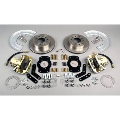

Summit sells a kit pretty cheap.
http://store.summitracing.com/partd...922533+4294839009+4294746628+115&autoview=sku
There is also the Scarebird adapters.
I was just thinking!? I was wondering if the backing plates would fit on an 8 3/4? The bolt pattern looks similar to the 8 3/4 housing minus the bottom bolt, if it is the pattern all you would need to do is drill a hole on the bottom. Then of course test fitting everything to see if it would work.
I wasn't aware that Summit had such a kit. I wonder it it's the same one as the one offered by TSM. TSM uses Eldorado rear disc brakes.
Are you using the kit from Summit in the photo with the 8 & 3/4 or is it the Scarebird adapter with parts you need to find?
Is that set-up from the Jeep Grand Cherokee since the axle is under the springs rather than on top? If it is, then as I understand it, the axle hole in the adapter needs to be slightly enlarged and the bottom hole drilled in order to fit an 8 & 3/4.
The set up from Summit uses 87-88 Thunberbird parts.
I'm using the Scarebird adapters which uses 1979 - 1990 Cadillac Eldorado calipers and 1982 - 1987 Lincoln Continental rotors.
I believe the TSM setup it very similar to the Scarebird set up.
Yes that pic is from a Cherokee. If they work as you stated that would be awesome. You would be able to do a setup that uses all Chrysler parts, probably cheaper and uses newer parts.
Those Eldorado calipers aren't cheap.
