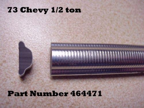

This is what I used on my front windshield... I never found one long enough to do the rear window... But, I did not really look all that hard as I had the rounded smooth lock strip that I had previously bought. This chevy ribbed one fit a little tighter then the round smooth...
Note: Not even sure if that part number is correct or not... but that's what they wrote on my receipt.
Measurements .562 x .236
Clif of Az. :coffee2:
