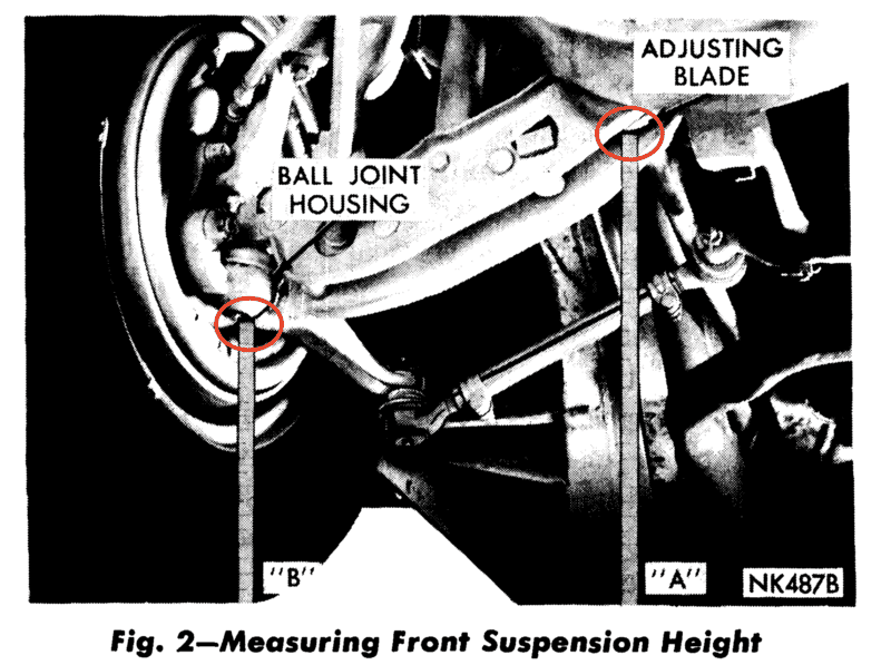

So I just checked the suspension height at the front, from the bottom of the adjustment blade to ground is 8.7" and from the bottom of the LCA knuckle is also 8.7". According to the FSM the suspension height for the Barracuda should be 1 3/8" +- 1/8". So unless i am taking my measurements in completely the wrong place that would be 1 3/8 lower than factory spec interesting.
So that measurement is taken from the bottom of the adjusting blade (torsion bar adjusting lever) to the bottom of the lower ball joint housing. The Barracuda was a bit lower than other A-bodies, which run that A-B measurement at 1 7/8". Either way if you're getting 0 that means your car is sitting fairly low in the front, and it should sit higher if you're not running larger aftermarket torsion bars and have adjusted your bump stop heights.
Here's a blown up version of the FSM showing the measuring locations

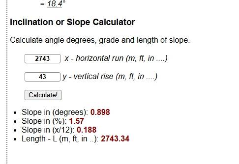

Raising the rear ride height will cause the chassis to pivot around the front spindle. If we pivot by 1.7" inches on a 108" wheelbase this draws out a triangle with side lengths 108 by 108 by 1.7 (the third side is slightly more than 1.7 because 1.7 is actually the altitude but this is a negligible difference). The opposite angle to the 1.7" side is 0.902˚, which is the amount the chassis pivots. Likewise, the line between the upper and lower balljoints will pivot by 0.902˚, which will be the resulting change in chaster.
Raising the rear ride height will cause the chassis to pivot around the front spindle. If we pivot by 1.7" inches on a 108" wheelbase this draws out a triangle with side lengths 108 by 108 by 1.7 (the third side is slightly less than 1.7 because 1.7 is actually the altitude but this is a negligible difference). The opposite angle to the 1.7" side is 0.902˚, which is the amount the chassis pivots. Likewise, the line between the upper and lower balljoints will pivot by 0.902˚, which will be the resulting change in chaster.
Do I understand? You are saying that if you lift the frame at the center of the rear axle by 1.7" it changes caster by "almost" 1 degree?
I see that I have made a mistake in my calculations in my posts [ above ]. I get the same as Remy, 0.9 degree change in caster.
Not quite, I had assumed the same, but when I drew out my representative chassis, what becomes clear is that the caster angle is originated at the front tyre to ground contact point, whereas the frame angle is originated at the front wheel hub, so the two angles are not directly linked as they have different origin points. In a way it’s similar to unequal length wishbone suspension, where the wheel moves the ball joints the same distance but because the arm to pivot lengths are different they end up at different angles.
