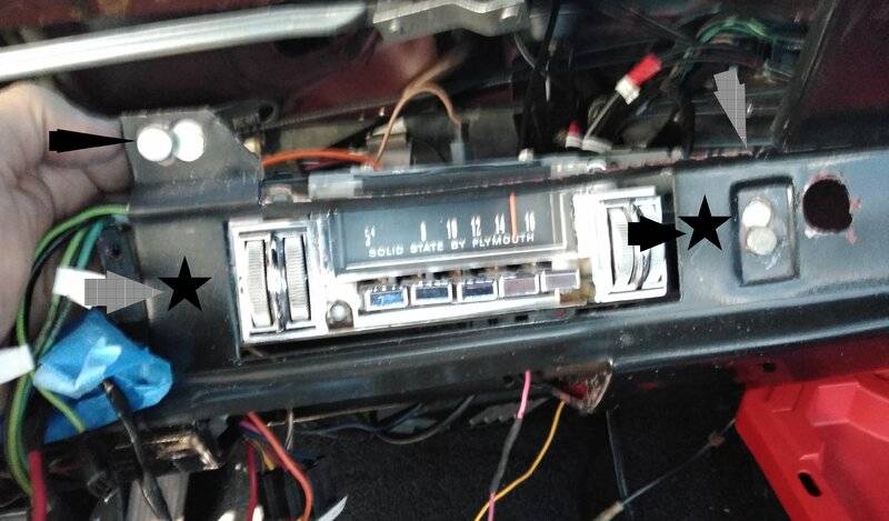

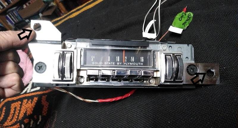

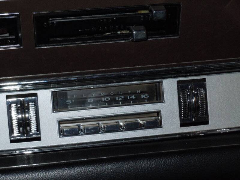

The mounting on the 68-69 Barracudas is different because the instrument cluster and the radio bezel is all one piece. The Darts, Valliant's and all the B bodies have a separate radio mounting bezel. Instead of the mounting next to the thumb wheels the left is offset above and the right is offset to the right.
These pictures are of the OEM radio

Do the mount plates swap?
if so you need the A-body mounts.
There are no mounts, just the holes in the dash with studs that slide in front to back. The right side is recessed and the left is above same way with flush mounting stud facing inward. If I drill and bolt through the front, the head of the bolt wont let the instrument panel lay flat against the metal dash
That middle pic is right. Is this what your new radio has?
if not replace the whole front bezel if possible

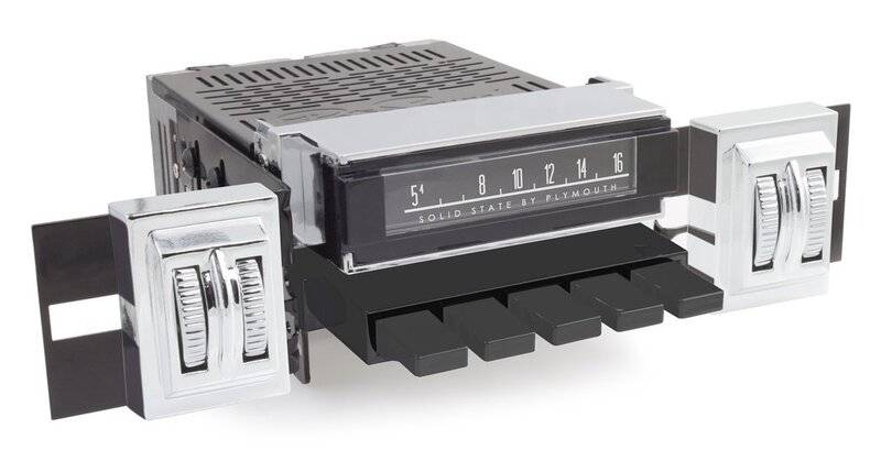

This is the new radio. The mounting are on each side. My oem radio has offset mounting as you can see. I dont want to cut the stock instrument panel
Wonder if the side brackets and thumb wheels are interchangeable to meet your desire and need?
I guess if you are handy, you can re-work the left side bracket to work. Does the right side line up?
if the stars in the third pic above are correct, then I assume the answer is no!
If really ambitious you could cut the right side recess from the dash frame and move it over, reweld and create the same on the left.
lots of work though!

Notice the Barracuda is different from the rest. That left mount is offset up and set back and the right side is just offset to the right.
No the right side is also offset to the right and recessed in a square pocket as in the pic
These pictures are of the OEM radio View attachment 1715704973 View attachment 1715704974 View attachment 1715704975
See those two brackets with the mounting holes attached to the radio? You have arrows pointing to them. Take them off the old radio and attach them to the black brackets supplied by Redondo. Then you can use the original mounting holes. I wasn't as lucky as you to have an original radio so I had to make brackets. Also, you will need to use the supplied bracket that attaches to the stud on the back of the radio to adjust height. There is a hole in the rear of the dash frame, luckily enough that you can use to attach it. You will have to play with the adjustments a little but it will fit ok. Here's a pic of my install
