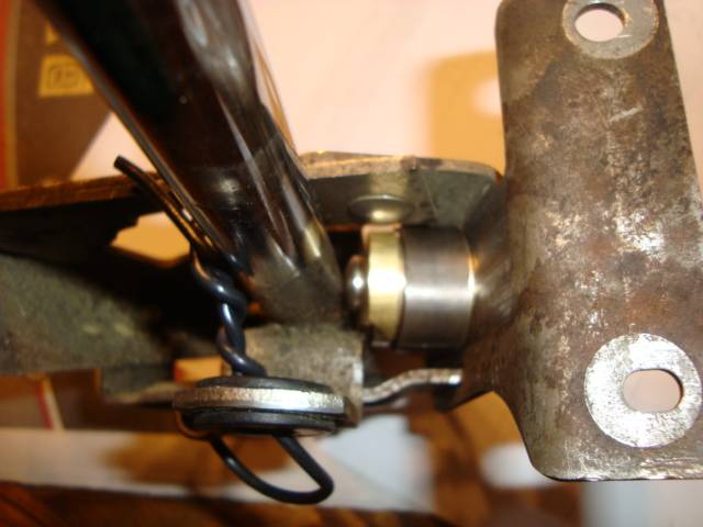

I installed a GM 2004R trans in my '69 Barracuda with center console, there was no way to connect to the Mopar NSS wiring. I used a simple push button type switch mounted in my shifter to have a NSS although it will only start in "Park":
Then I got a reverse light switch off another year model to get my reverse light to work.
I think that by using those Magnetic Cylindrical Plastic Sealed Reed Proximity Switches instead would have been easier and less bulky and I could start the car in neutral as well. "Pawned" never mentioned where you buy those switches or where to get the tiny magnet??? FABO members would need to have that info to copy the idea because many of us are not familiar with those gizmos?? I can also imagine other applications for those switches when you have something that moves out of position and you need to have something actuate relative to the movement.
The extra switch you see mounted to the outside of the shifter bracket is an "override" switch in case the NSS fails. I can easily access it by sliding my hand under the console.
View attachment 1714991665 View attachment 1714991666 View attachment 1714991667 View attachment 1714991668 View attachment 1714991669

They have a few different ones at the Oriellys. Most auto parts carry them. I got the one that could handle the most amperage just in case.

Actually it can be placed anywhere on the column. This is just where I picked, probably because I have so much problems moving around, this is the most accessible to me.
I started to pull apart the steering column to make it internal to it. When I thought about doing any service to it, I did not want to pull apart the column again.

I do not know the rating on the switches. That is why I bought 10 of them. But the circuit sets the small coil in the starter relay, not alot of current - it does not carry the starting motor current.

Yes the switch connects the relay to ground which makes the circuit to energise the relay's coil.
Originally, the G on the Starter relay connected to the center pin on the NSS. When the tranny was in park or neutral the center pin would connect to ground.
I had originally intended to use my switches to operate relays that would make the ground connection. But as I have spare switches, I decided to try not using my relays and seeing if the switch could handle things. So far so good. If the switch malfunctions due to high current flow, I will then use my relays. If that happens I will add an update to the thread. But I think all is golden for now

I just now placed an ammeter on the actuating coil of the starter relay. The maximum current measured while starting the car was a whopping 3.1 milliamps. or .0031 amps
I just found the specs on the magnetic proximity switch :
max contact rating:10w
(in case you are interested in the rest of the specs.)
max switching voltage:100vdc
max switching current:0.5A
min breakdown voltage:220vdc
max carry current:1.0A
max contact resistance:100mΩ
release time:0.1ms max
operate time:1.0ms max
Diameter :6.08mm
So it looks like my guesstimate is/was correct
BTW regarding the magnetic. I found that I need to cut the magnet in halves or quarters. The car wants to start in drive, so a smaller magnetic should help

oh BTW I changed the design of the switches and it has worked flawlessly for over 18 months.

My thought would be to test the proximity switch with a similar load away from the car,say a bulb and a battery.
Run it for several hours or days and see if it will fail.
Those switches are used in household alarm systems, and some can be wired n/o or n/c.
As long as they are secure, they should be dependable.
