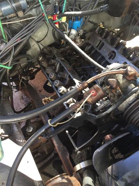

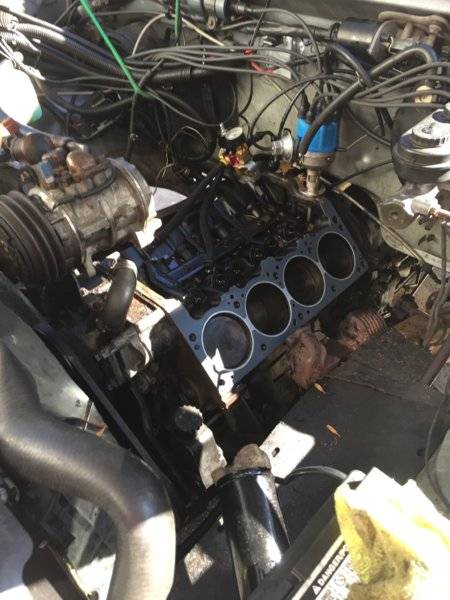

yes its possible i just did this last week. but if you have a brake booster you have to remove it. Also chasing threads and trying to keep all the push rods in order when pulling apart so they go back the same. also there are two notches at the end of the rocker arm shaft driver side points to the front and passenger to the back.
