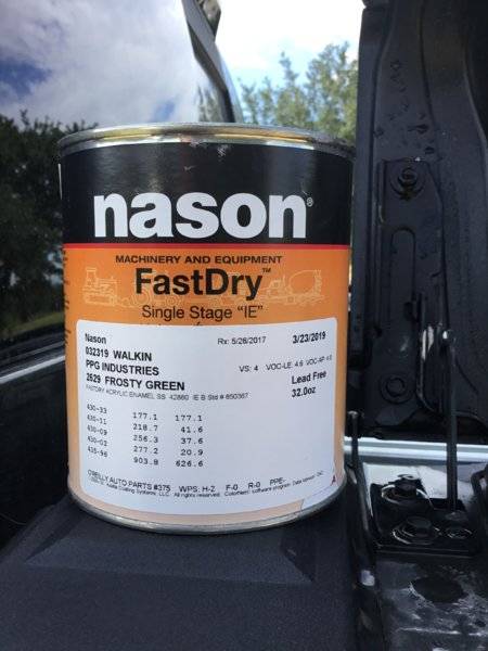

Let us see the tag on the can of paint you used. Take a picture of it.

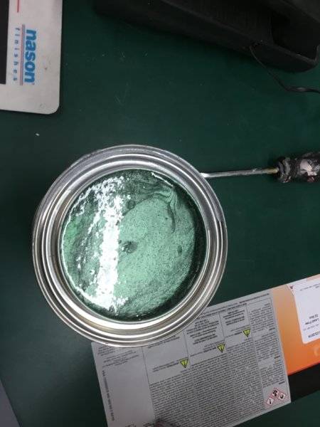

So the car was (spray) primed several years ago ahead of me getting it. I sanded, scuffed, reworked, etc before “re-“ priming with the OEM recommend primer. I think it was a 421-19 (?). This was the result of one of the more recent conversations with Nason. Then, I 320 sanded post-primer and shot what’s in the pic. It laid down great, not unhappy with that piece. SUPER unhappy that I can’t buff it. I had asked a couple of others where they got their paint supplies and they said surprisingly, o’Reilly’s mixes and sells automotive paint. And they had by in large had great success with it. So when I visited the part store, we had lengthy conversation, or what I felt like was the appropriate amount of conversation, for what I was doing. This was the paint the store had suggested, and after visiting with the manufacturer I had no reason to suspect this was the wrong application. It calls out machine on The label, but because all signs pointed in the right direction, I assumed this was just their focused industry. I would suspect that any application that I put paint on, even my engine, would last longer than a couple of years and provide for a great finish. And if I shared with the manufacture it was going on an engine, well they would provide feedback regarding the correct application for what I was using.
Also, I went ahead with the cowling only because it’s getting a vinyl top back on it which come down on the pillars to the cowl. I figured it would be more noticeable as a stand alone area vs shooting with the engine bay. Maybe not but figured I could scuff for profile and repaint if I’m not happy with it. It’s the smallest area in question.
One point though worth mentioning, they also said you can’t paint over this “IE” I used. I think they said because it’s not activated, or bonded maybe? I will admit, when he said “....wrong paint” not much after that stuck with me.....
I've never heard of "IE". That looks like a pretty important question. They placed the mix label directly over the original can label. Who knows what pertinent info that's covering up.
maybe the E in "IE" refers to enamel. If that were the case, it's been my experience that enamel has a hard "shell" with a soft underneath. If that is the case, then yeah, it wouldn't last long if it were wet sanded and buffed.
On the web site it showed the following:
Ok so i looked it up and yes it is a single stage enamel that gets reduced but not catalyzed. u definitely do not want to buff that. U will have major issues. Thats basically a tractor type paint. Spray and go. The only 2 options i see are strip it or if by some miracle u can try 2 lightly sand and cover it w epoxy sealer and see if it takes. Then spray your new paint. But this is a total gamble and no guarantee it will last

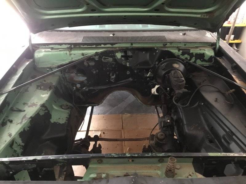

That said, what is the best way to get it peeled back down to the appropriate level and start over? There’s no way I can strip every nook and cranny like it should be, not by hand. I don’t see anyway other than blasting it. But, I don’t want warping problems either. Best way to go at getting it off?
U could try chemical stripping but it makes a huge mess and if not thoroughly cleaned afterwards it can cause issue . I sandblasted my whole car. No warping. u just have 2 b patient and take ur time.
I am not at all opposed to blasting the car. In fact I actually think this IS the right way to do if I want the results I mentioned. I just would like the input from others who have been successful doing it.
What media did you use? Grit/grade? What equipment did you use and at what pressure did you run? Are you safe “er” if you blast at a steep angle, say 35 degrees or better?
Again, got all the confidence in doing it and being cautious, but would just welcome any and all insight in making it a success.
