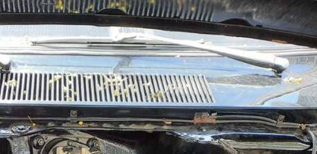

The photo above is from a '68 but that's just a sample of one that we presume is a survivor.

I will report my findings on my 68 Dart. This is the only pic that I have right now but you can't really see the wiper.
