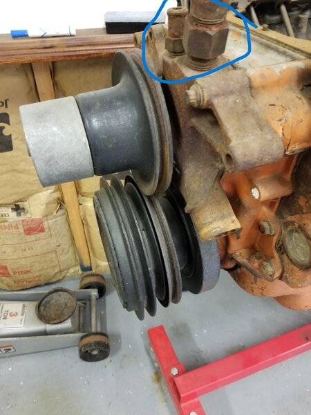

ETA: you're going to need to lose that adapter you have on the bypass coming out of the pump. it's way too tall and you won't make the turn going into the manifold without kinking it.
Re. ETA note...Here is the old hose that came off of it.

Good catch on that bypass hose barb. I have no idea why the PO did that. I'll fix it. Thanks.
