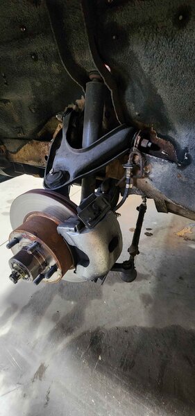

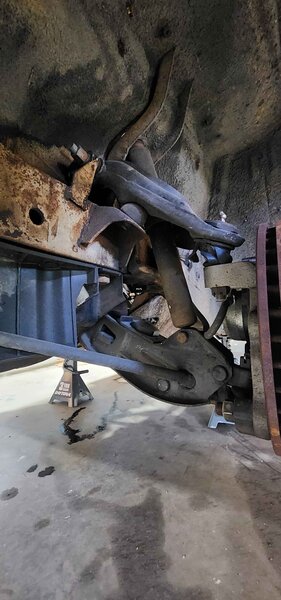

I've got this 4 door 68 Dart that has been lowered by the prior owner, and I'm wondering what parts I need to order and what needs to get replaced or swapped out to return to stock ride height.

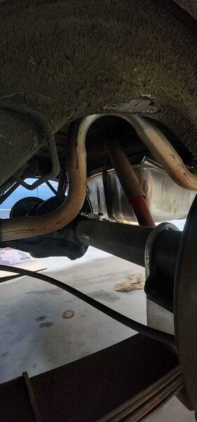

It seems like the rear shocks got relocated, not sure if I need different ones or certain bolts to redo that, ordering U bolts and getting rid of the blocks is simple enough.

Lose the rear lowering blocks and get shorter U bolts; then get rid of the front drop spindles and replace them with standard '73 and up A body disc spindles. Everything else can stay the same. Then get an alignment.

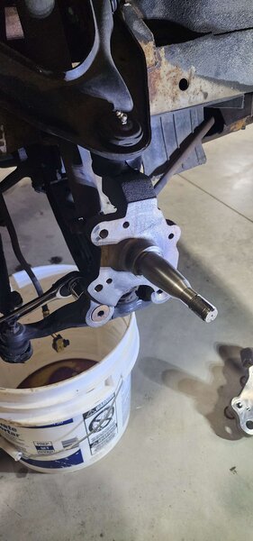

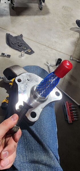

I would be interested. I ordered some but I'm pretty sure they wont work, the new ones aren't recessed for the bolts to the tie rod? and both shapes look completely different.
That's because factory type spindles don't use countersunk bolts like your aftermarket drop spindles did- they use a hex head bolt to attach the lower ball joint.
But be aware that the correct bolts have a thinner head than standard bolts, to give them sufficient clearance to the rotor. Many aftermarket bolts do not.
Two solutions:
Have a shop turn down the heads a bit (maybe by a third?) to get the necessary clearance.
Or
Place an ad in the "Parts Wanted" section for some factory originals- they show up fairly often in the Parts For Sale section, too- a quick search there may turn some up.
