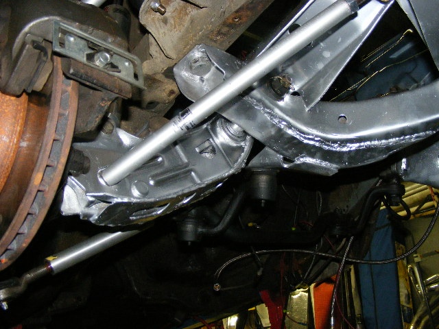

I have the hymed RMS strut rods on my 66 Dart,but have yet to try them.Race season starts soon!:burnout:

Dan, other than better handling and stopping, we installed a complete Hotchkis set up on the MATS giveaway car ( 67 Coronet ) and I can honestly say that I didn't notice any noise or harsh ride with the heim joint type.
