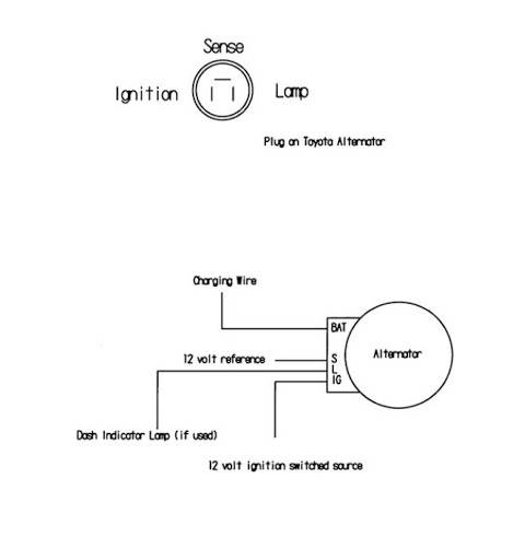

For reference, this is what the alternator looks like:
The charging wire to the battery/starter relay goes to the large post on the alternator. The other three terminals are as labeled in the diagram below:

I'm pretty sure Ron Fancis harnesses include an "exciter" wire to the engine bay. Look for that which goes to the IG terminal in the diagram
Above, you would run a separate wire direct to battery from the alternator "S" terminal. I would inline fuse this. It is very low almost no current, the "sense" wire.

Thank you for the diagram. Sadly, I don't understand the terminology. "12v reference" means what / where? Does "12v ignition switched source" mean 12v supplied to the fuse box or 12v supplied from elsewhere?
Okay. Running the sense wire to the battery is easy enough. Thank you for that. I can easily put a fuse in there.
I followed that 3-wire diagram mopowers posted. Been running it for 10 years with stock 50 year old wiring harness.

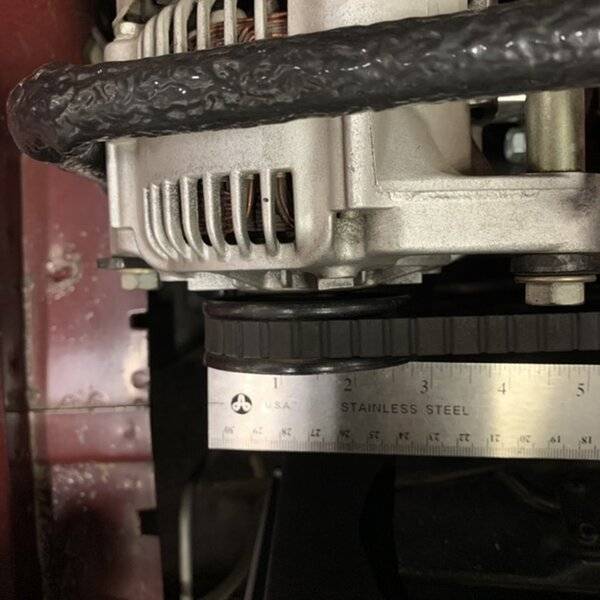

I think mine came off a 4 door car. Like a Geo or Nova variant. It had a V-groove pulley.
It’s 2 3/4” diameter OD.
My water pump pulley is 6 1/2”
My pulley centers are 9 1/2” apart.
On heavy acceleration, it squeals. Pulley alignment is spot on. Wonder if the ratio isn’t right
