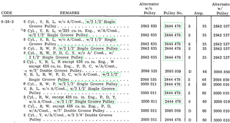

Difference... 2 groove was 3", 1 groove was 2.7", parts book calls for 2.5". It would probably charge with the headlights and brakes on at idle with a 2.5".
Pretty sure 2.7" OD might be 2.5" effective diameter.
I found the same OD on the factory type pulleys I have.
The V belt lengths are sometimes sized by effective length, and other times outside length.
Here's one got from OMM with the stamped number still visible.
Just had to check. The stamped number is same as the part number for a 2 1/2" pulley

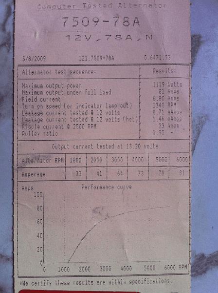

Here's a test sheet that came with a remanufactured '78 amp' revised squareback.
A couple things to keep in mind when looking at the remanufacturers test results:
RPM is alternator rpm.
The load was applied while holding 13.2 Volts. (If it was regulated to 14 or 15 Volts, the output power would be the same and therefore the current output will be less)
Also notice the field current draw is 6.8 amps !
