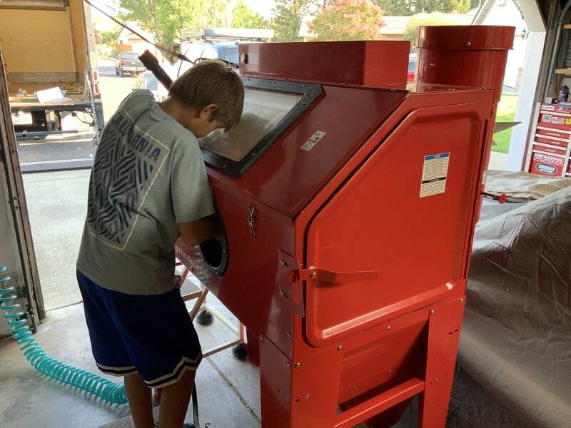

I bought this one recently awesome piece of equipment. Was going to also do all the upgrades to a cheap HF but figure to get parts to upgrade plus i wanted a larger cabinet ill just spent the money. I have cleaned k members leaf springs with the lower spring sticking out into a made catch on the side. I did add magnetic LED lights. Also added a larger air hose 24" x 48" Blast Cabinet at Grizzly.com
