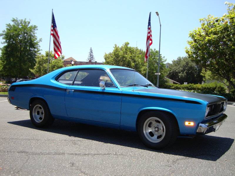

im used a stainlees steel brakes kit on a 10'' drum spindle on a 71 duster , came with everything , had dual patterns , 4'' bc and 4 1/2'' bc on the hub/rotors . and nice four piston calipers , in alum or iron . this kit does add width to the track so your tires will get closer to the fenders . and 14'' steel rims would not fit over the alum calipers .
im used a stainlees steel brakes kit on a 10'' drum spindle on a 71 duster , came with everything , had dual patterns , 4'' bc and 4 1/2'' bc on the hub/rotors . and nice four piston calipers , in alum or iron . this kit does add width to the track so your tires will get closer to the fenders . and 14'' steel rims would not fit over the alum calipers . View attachment 1715415832
