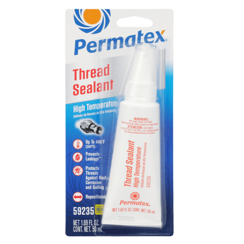

Use the white Permatex Hi-heat thread sealer on the vc bolts. Stops oil from wicking up the threads. I wasn't a believer until I tried it. I now use it on all timing cover/water pump bolts too.
I did check, but can't remember if they are open or not. Regardless, I would always have "leaks" around the bolts. On my latest build I used the permatex and it sealed them right up. Dry as a popcorn fart now.
I wasn't aware the valve cover bolt holes were open to oil.
It wouldn't surprise me if they might leak regardless since the holes make that area of the valve cover rail pretty thin.

Yep I'm getting what you're saying. The ONLY leaks were coming up bolt holes and I took @str12-340 advice and used Permatex and it solved it. I guess I'll have to chk 318 heads I have on shelf to see if holes are open or not. I used thick gaskets, can't remember if Fel or MP.
I can't add anymore than what has been posted by everyone else except the Permatex worked lol.
I'm not sure you are picking up what I am laying down Steve. The sealing of the oil needs to be before the fasteners.
