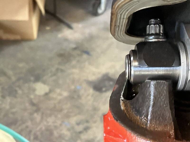

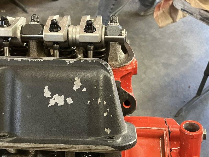

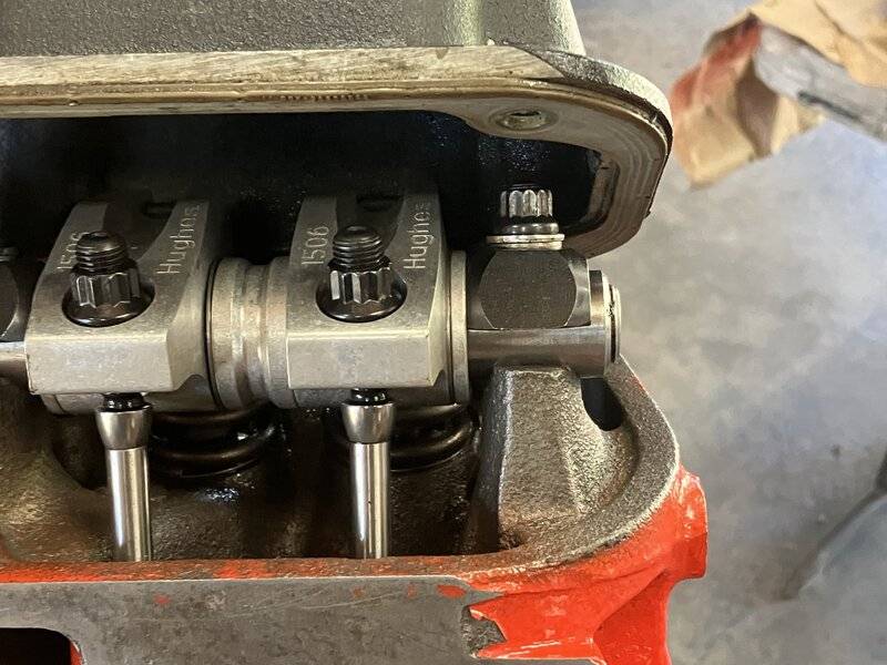

These are Hughes 1506 rocker arms. They are not any longer than stock from what I can tell. I tried to set the Magnum valve cover on the head and they won't go over the shafts.

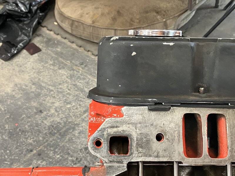

Just to confirm, I pulled a valve cover off of a stock 318. I couldn't fit the valve cover over them either. It isn't a gasket fitment issue. The body of the valve cover is not wide enough.

I agree that the Hughes rocker shafts may be longer by a small amount but these valve covers didn't fit on a stock 318 either.
Looking at the pictures you posted, I'm not sure the valve covers will fit if you removed the pipe plugs. Simple enough to find out. In fact, I wouldn't be intimidated in the least to shorten the shafts dead flush against the end hold downs and even tap the shaft ends deeper so the plugs will fit flush or even a little counter sunk. It's a really simple fix. Just take your time. You can make it happen.
The pictures were for mock up only. The valve covers belong to fellow FABO member @RBConvert who is building a 5.9/408 here in the shop along with me building this 360.
He has PRW rocker shafts and arms. They seem to be about the same length as these Hughes ones that I have.
It is probably possible to pull the shafts and cut them back enough to fit but I'll bet that he'd rather just buy different valve covers.

Before I cut them, I'd remove the plugs and see how close the covers are to fitting. If they do fit with the plugs out, you can simply take a pipe tap and tap the holes a little deeper so the plugs will fit flush or a little counter sunk. But yeah, it might be looked at as a bit of work when there are other covers that'd work.
