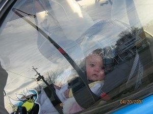

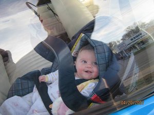

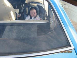

why not just use the normal kid car seats? thats the proper way to do it and safest way. you lock them in with the the factory seat belts. that's what i do with my 16 moth old. she road in my dart a lot last year at 6 months old. here in jersey and i'm pretty sure though-out the states they need to be in a car seat till something like 100 pounds. then a booster seat.
here is a friends kids in his cuda..
this is my girl when she was really little in the back of jamies dart..

the lap belt hods the child seat in the car and the kids seat should have its own harness to hold the kid in. a strap over each shoulder, a strap between the legs and a strap around the waist. not sure how much safer you could even make that. maybe i'm just not understanding what your talking about.
can ya see the pics now? i can see them on my side .
