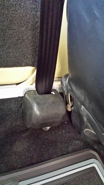

I put a set of the wesco ones in the front of my 72 4 door.

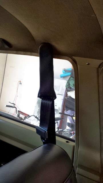

I ordered the ones with the longer shoulder guides, as using just the coupe ones would have had the shoulder belt riding my ear. These are part number [FONT="Trebuchet MS", Arial]#SBS-lng-sash, from Wesco Performance. [/FONT]
The retractor is pretty sturdy, but is a bit picky about the speed in which you pull it out to put it on. It doesn't bind or anything....just likes to lock under the lightest strain.

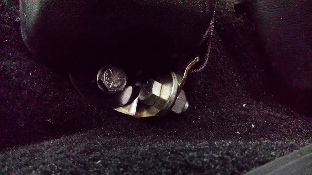

Here is a shot of the 3rd point mounting that I had to setup to mount the end of the lap belt. Using the stuff in the seatbelt mounting kit, I added the little "L" bracket to the seatbelt to floor bolt, and bolted the lap belt mount to that bracket. It's all setup with grade 8 hardware.
