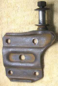

Are there a difference in shock plates. When I pulled my rear one of the shock studs were broken on my shock plate. I wound up picking up a pair cheap on Ebay. When I got them one was different from the other. Of course the seller didn't state that in the auction.
I have one that looks like this.
and the other looks like this.
The one I have with he broken studs look like these.
I have noticed people selling them both stating they are for an 8 3/4.
Is one maybe a lot stronger? I bought a pair off of ebay awhile back, the guy said they were for an 8 3/4 rear and were repainted. When I got them they were brand new and powder coated, never used! They were way more heavy duty (thicker) than the stock original ones I had, also a little different but mine fit fine.

Isn't that un-safe? The 8 3/4 shock plates are different, stronger and more beefy. Wouldn't elongating the holes on the 7 1/4 piece make it even weaker? :scratch:
The only difference I have seen between the 2 1/2" shock plates and the 3" shock plates is a slight increase in the length to accommodate the larger u-bolt. The 1/4" elongation on each side is not significant in the overall strength on the plate. Plus the plates are not subjected to huge loads anyway so I see no issue.
It's been like that for a little over 30K miles, the bolts haven't loosened up and nothing has shifted.
