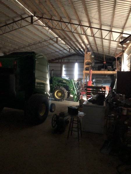

    So its time to upgrade my pole barn lights. These were in when I moved in and I'm tired of using trouble lights to get anything done. Any ideas on how to improve or pics of what you
    are doing would be greatly appreciated.

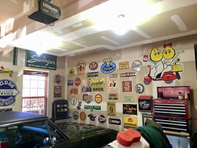

        Yup, I just redid my garage and converted all the old fluorescent tube fixtures to work with LEDs
        Snip snip to remove the ballast, couple of wire nuts to hook up the bases to the 110 and done

          They are Omni directional and I bought them on Amazon. I have 2 in the 400 sq ft garage and six in the 1200 sq ft basement.
          They screw into standard bulb sockets so it was a no-brainer to replace them with these.

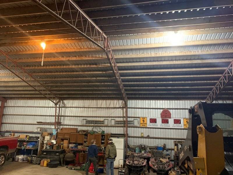

                  Here’s an ok side by side comparison. The one on the left was a 200 watt florescent , compared to the one on the right, which was the one I linked above. That’s a 22ft ceiling peak. I’ll get some Better ones tomorrow as that is with just one installed. We now have all 4

                    I'm looking at the shadows on the wall from the first light being wiped out by the brightness of the led. Pretty impressive, thanks!

                      Yeah I was skeptical when my brother said, hey go buy these bulbs for 40 bucks a pop. I’m sold now.

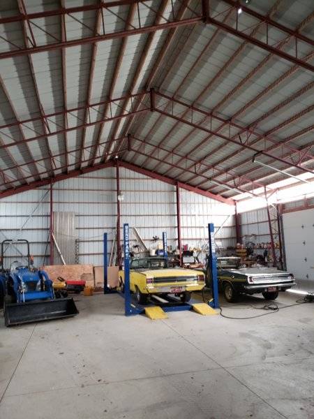

                          Here’s in the daylight, with one , 24 ft by 16 ft door open. No lights on.

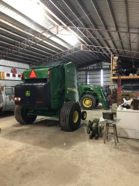

                            This is a with the door closed, 2 Fluorescent lights on

                              This is with 4 of them on, still have two more to replace. Doors closed. But I think you can get the idea
