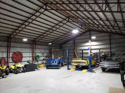

Yep. Right now, just have two of the 10,000 lumens installed. The other 2 go on the far end and I have to move the non running project cars out to get the tractor in there to reach the peak.
Then eventually the two Fluorescent tube above the lift closest in the photo will get swapped out as well.
That shed there is 80x40x22h
Did you use the front loader on your tractor for the light install?
Yep. Due to the height, we have to strap the tractor to the fifth wheel and back it in. Someone climbs into the pallet lift bucket we made. Not exactly osha approved but safe enough
