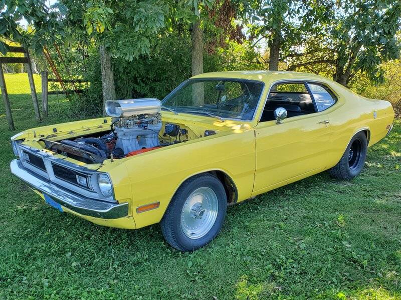

15x6 and 15x8 Cragars, before it had 15x7 and 15x8 Rallyes

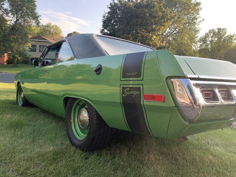

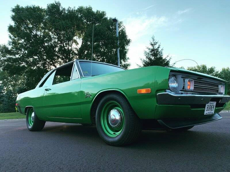

Wheel Vintiques 63 Series 15x6 Front and 15x7 Rear, 4" backspace. 205/60 R15 Front, 215/60 R15 Rear. Ended up with about 1/2" clearance at wheel well and 1" at stock springs.

Mini tub? Those 8” rear look pretty damn good! What is the back space on them? Stock rear width? 4” pattern?
Ok, changed it since my last pic. Added some Cenferline 15x4s small 5x4 pattern out front.
Are your 8" rear rims the standard (no offset) 4.00" backspace? Thanks for the help.
I don't know which Ron has, but original centerline autodrag 15x8 1/2s came with either 3 5/16 or 4 7/8 backspace.
From the look of the second picture with the car driving away, i would guess they are the 3 5/16.
I will pull a wheel and measure I've only had he car a month so I'm not sure. They fit and fill the wheel well without rubbing but it's close.
I didn't pull a wheel but putting a tape measure against the back of the hub and eyeballing it Looks like 4" to me.
