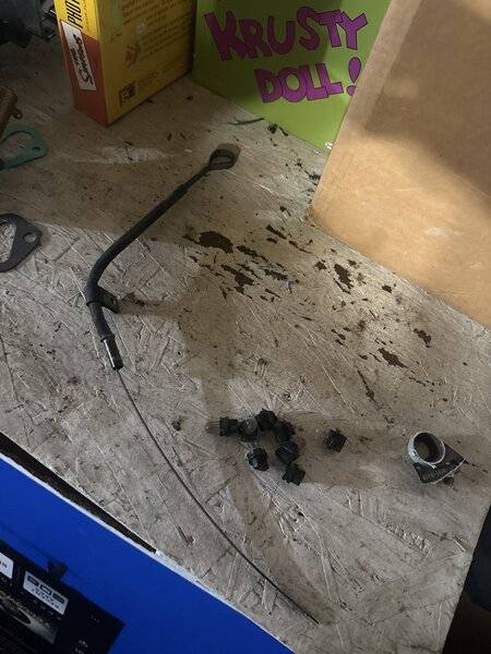

I can’t remember if this is from an early a body, or a later a body. I’ll do $40 plus shipping on it. I use pirate ship so it should be reasonable.

Not a real early one....those have a very short tube. They made several different ones through the years. If it came from a car, it should work as a set.
Is that tube bent that much originally, or did someone bend it more? I don't know if that's right for my Slant Six, its tube is straight.
