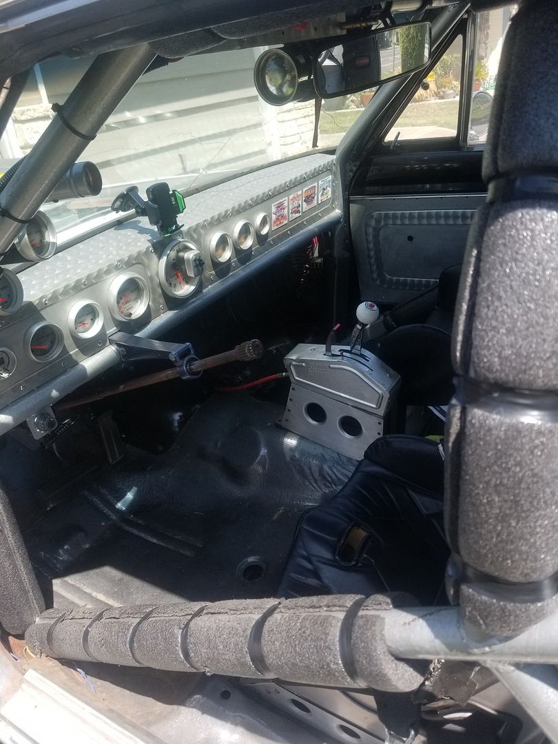

Here's that seats natural environment.
Even tho its not easy to get in and out of my car I'd bet its a hell of a lot easier than getting out of your car.
I can use the cage to lower my *** down or pull on the cage to lift me out.
One issue you have is nothing to help you get out.
I think you have the incorrect seat for your application.
