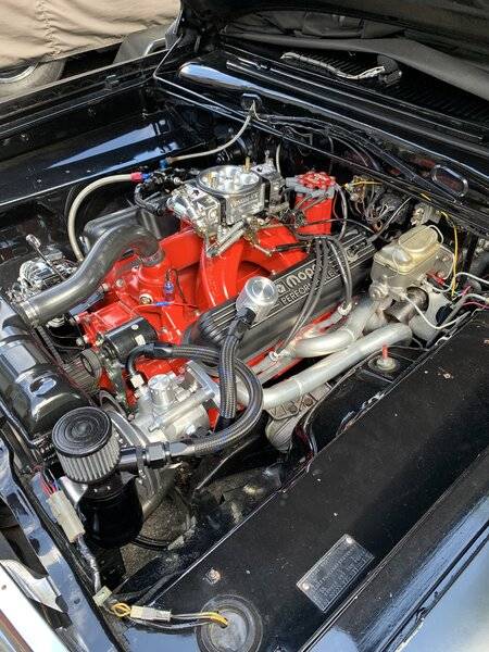

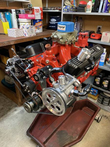

Damn looks like you was on to make a great pass. Sorry for the damage. Do you have any engine pics? I need to get off my butt and order my kit.
Too small. 1 5/8" step to 1 3/4" TTI's into 3" exhaust with an X pipe and Dynomax mufflers.

Hi. Can you make a list of what all you have in your 426 engine? I was going to order the huges 426 kit, but they are out of stock till the end of June. But its looking like a lot of places are out of stock. I was going to order a 408 kit. But so far everybody doesn't have anything. Oh well give me a chance to save up more money.lol
