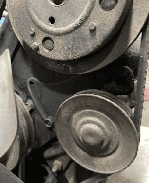

I have a small block 74 Cuda with AC and manual steering. It has a redneck engineered idler pully in place of the power steering pump pulley. Does anyone have a picture of the stock idler pulley bracket for a small block they can share with me, preferably a picture on the engine would be helpful.
In later years Chrysler used one on the small block. I forget what was deleted… I think it was the lack of A/C got the idler pulley.
The proper pulleys fix that.
This is from a '68 with the cast iron water pump. Your '74 could be different.
Small block with AC had an idler pulley I have one around here somewhere but no way I would be able to find it. It was a V pulley, not flat like pictured above.
On my '69, factory AC, the passengers side had V groove idler and drivers side smooth like in that photo. Both idlers were for the single belt AC setup.

for 1970 small blocks there are an entirely different set of pulleys and belt pairings for AC cars and non-AC cars. In that system the AC and alternator run on a double belt. Did you car actually come with AC and no power steering - I don't think I have ever seen one like that before.
I have one hanging in the garage and a picture of one on the engine. I can get a pic of the idler and pulley but the picture-I will have to dig for. They are rare. If I remember it mounts on the passenger side and uses a real short belt, a 13371.

Pictures and part numbers for the bracket and idler pulley can be found in the 1974 Chrysler parts catalog. Look in Group 7 in parts catalog which is available at Mymopar.
Looked up the info, hoping for the best. None of the pictures of the pulley setups matched the situation I have. I believe all the engines had power steering so that didn't help much. I have an idler arm bracket and pulley already that does not appear to be a Mopar item as there are no part numbers on it. For now, I will modify the existing setup to be stronger and more factory looking. I think my son wants to put on a tubular k-frame with rack and pinion steering so a power steering pump is in the future and the situation will resolve itself. Thanks for the inputs!

In the 80s. South Florida, my brothers 70 Duster 340 had AC, manual steering. Very unusual. It was a V groove idler with a bracket bolted to the driver side water pump.
FWIW....I can't see the overall accessory drive/belt layout on anyone's car that posted on here. But idlers are typically used to increase belt wrap on a driven component. You want the proper amount of wrap to prevent belt squeal or slip. So if you're looking to see if an idler was needed or used, look to see if a component looks to have insufficient belt wrap.
